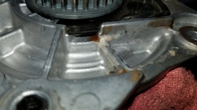

Update with 2 images. So less than a 1000 miles since getting the thermostat housing replaced I noticed my coolant level was ever so slowly going down. (I would check with the engine cold to get an accurate measurement). Thinking maybe some air was being bled off I was patient until I could see coolant collecting on the undershielding. This is a slow leak and if my car wasn’t under warranty I would just monitor and add, but because we have outdoor cats (G13 does have some glycol) I opted to get it fixed now. Here are 2 images of the leaking water pump.
