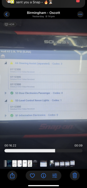

1st issue, this is my Snap on Solus+ reading the codes, but the the esc fault is on the dashboard as well as TPMS and steering goes tougher but if I clear it and I’ll drive it’ll go away for a few seconds then kick back in.

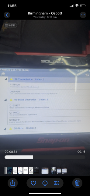

2nd issue, the transmission cycles through all gears smoothly but if I’m in first and plant my foot when I reach higher revs the transmission jumps out of gear and the car throws itself forward as it bogs down then it finds 2nd or 3rd after a couple seconds and continues. No idea what this could be as the transmission was fine prior to reinstalling into the car.

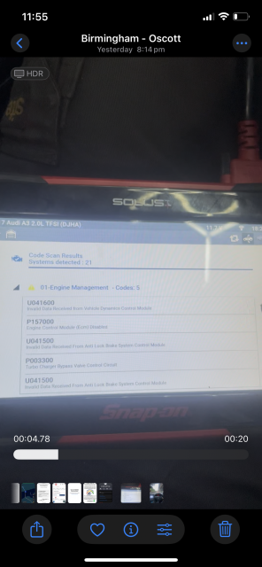

I have attached pictures of the codes. I suspect it’s some sort of CAN communication fault as so many modules are affected but can’t for the life of me figure out how/where as I’m sure I’ve plugged everything in. The only thing that isn’t is the sensor that goes to the A/C pump as that ripped off and I’m waiting for a depinner to repair the wires. Could this have cause some sort of can fault between the whole car?? As I’m sure the AC plug only has a live and ground and no signal wire.
