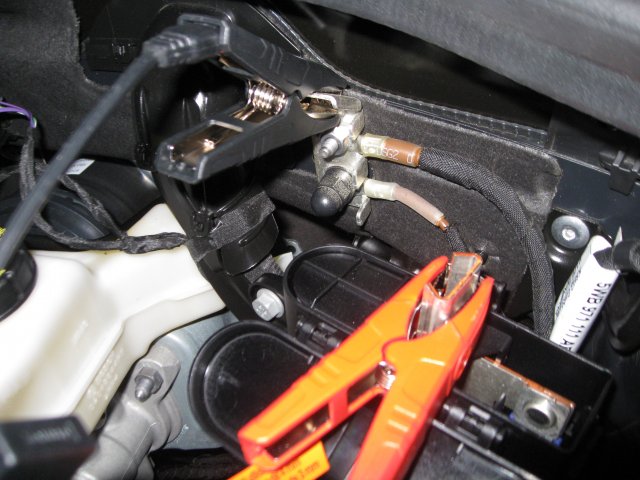

Where would I hookup a battery tender on a 2025 S3 and would anyone know much about the animated headlight settings as it's not listed anywhere in the owners manual. Thanking you in advance for your help.

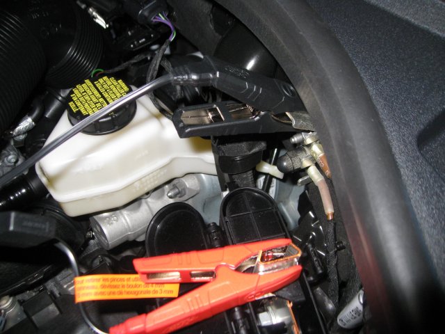

I found the place where you can attach a battery tender to. Located on the firewall on the drivers side. It's the same terminals you would use to jump start the car. On my prior car, C7 Z06, there was a 12 volt outlet in the back hatch area where you would just plug in a battery tender. The S3 also has a 12 volt outlet in the trunk but not sure that is a good spot for the battery tender. So far have been using the engine compartment firewall spot and it's working fine.
