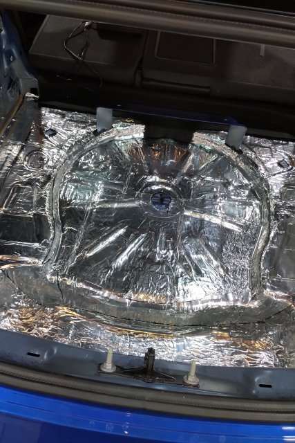

just finished the trunk.
here is a photo of the roller tool i used.
tomorrow will be the rear deck. to much work to finish in a day both sections. lolz :cry:
i hope you guys likey. ;) :p

one of the things i noticed about the tire well, it is super hollow. it really needs this process.
since im in southern cali, the heat is really strong during the summer.
when i leave something in the trunk i noticed that it gets really warm. so if its groceries, it will spoil the food fast before i get home during the summer drive. this product is supposed to make another barrier for any heat transfers. whats weird is that the bottom of the trunks must be really hot. because between that tire well, is the tire, then some foam, then carpet. and the trunk can still get warm. i feel its partly the exhaust heating up the bottom of the trunk.
so ill give a report back with our expected heat wave for this summer.
