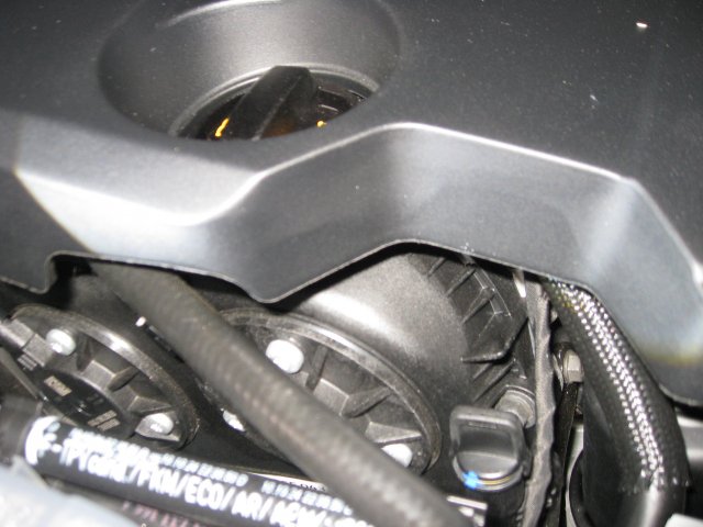

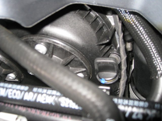

I basically have the same question with my new S3 and it's not that clear in the manual whether you have a dipstick or not. They said you check the oil level on the instrument cluster but after looking all around the engine I saw what appears to be a dipstick on the passenger side near the front of the engine. Only thing is that is has two locking tabs on each side of the top where you would normally grab it and pull it out to check oil level. Not positive if that's the oil dipstick or maybe something that would check transmission level. Here are a couple pictures so that you can see for yourself. You can see the dipstick as it has a little blue marking on it.

Unfortunately, that is just a plug that goes where the dipstick should be. I reached out to FCP Euro, and they advised me that this dipstick fits:
part number Audi VW 06K115611AB -- I just replaced the plug with the dipstick. The dipstick oil level matches the reading on the screen. I'm going to continue checking both, but I prefer having a traditional dipstick.
